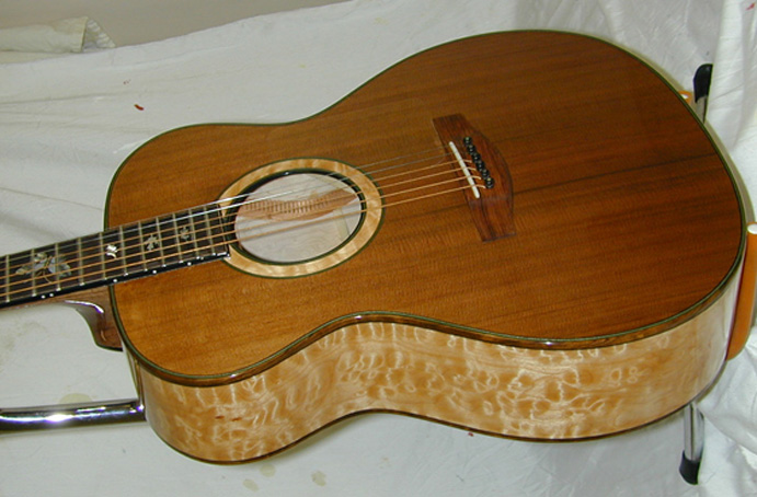

Heres one from a few years back - my neighbour and I built this together, this is when we had jsut started finishing ..
PostPosted: Tue Jan 17, 2006 12:32 pm
Gorgeous guitar Tony.
PostPosted: Tue Jan 17, 2006 1:00 pm
Posts: 697
Very nice! The small backstrip works well and the bookmatch is perfect.

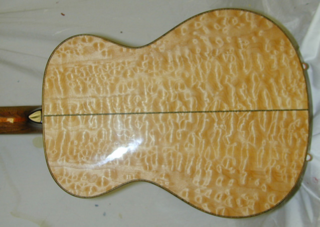

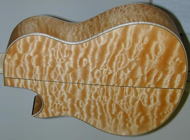

In another thread some one was talking about a maple/cedar gutiar - well I found the pix of mine, this one was number 5 way back. The purf does indeed have a deep green line int here, the rosette is one piece quilt as well, and there are maple and oak leaves plus a big butterfly in the FB. Bridge is honduran RW.
PostPosted: Wed Jan 18, 2006 12:06 am
And the back - I saw these billets in the kiln out at Pacific Rim TW back in 93 - had them ship me a set once is was all dry. It sat around for 7 years before I finally built with it.

That was me asking some time back as I'm currently making a Cedar/European Maple Grand Concert'ish size guitar.
How did the wood combination turn out in terms of sound?
PostPosted: Wed Jan 18, 2006 1:23 am
The guitar sounds pretty good, warm tone, but still has some brighness from the maple - its a little over braced compared to how I build now, so it could be better as far as bottom and volume.
